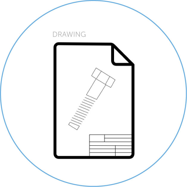

TOLERANCES
Drawings accepted here
Upload your drawing to our platform and save time communicating design intent. We’ll ensure the following features are made-to-spec:
  • Tolerance variations as low as +/-0.025mm (0.001")
  • Tapped hole call-outs (Metric, UTS, NPT)
  • Critical features (bearing surfaces, reamed holes, snap fits, etc.)
Engineering drawing for CNC machined parts
Don’t want to create a drawing? No problem. All parts are produced to our ISO 2768 medium standard.
